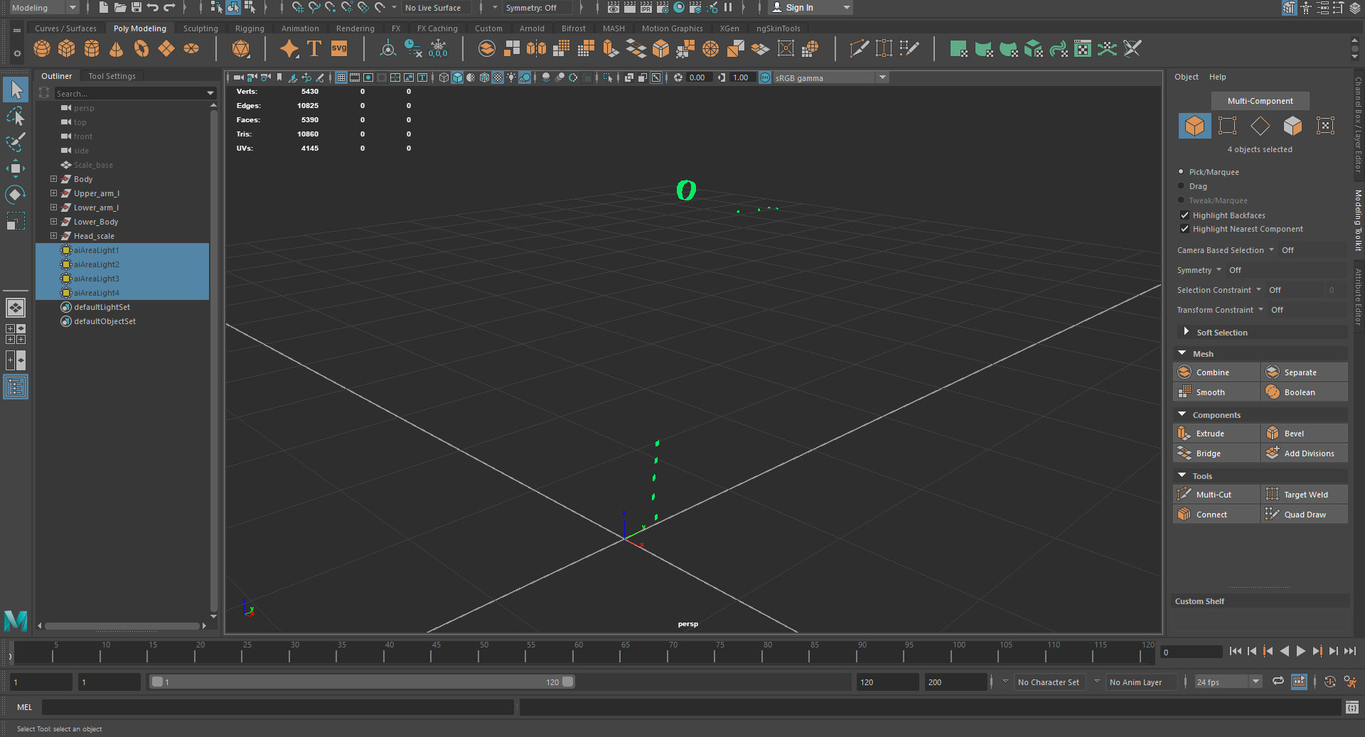

Was working on a model lastnight. Opened up this morning and everything is invisible. Well not everything. For somereason somethings are showing up bright green and other things are just gone. I know this isnt just  invisible or anything because it doesnt show up when rendered and the invisible objects say they dont have any polys.
1,214 Views
Btw heres the scene file
mspeer
Hi!
I am not sure what happened here, but some of your meshes are indeed empty.
However you can recover some data.
Please check in Attribute Editor for secondary nodes like "polySurfaceShape" and disable
Object Display -> Intermediate Object.
For example Body has BodyShape which is empty and polySurfaceShape2 which can be recovered.
Maybe it's better to  start from a backup, but if you don't have one, then at least some meshes can be recovered.
Any reason as to why everything is green? I have materials that were assigned when i left it and somehow they are green now?
mspeer
Hi!
Some connections are broken, just re-assign the materials.
