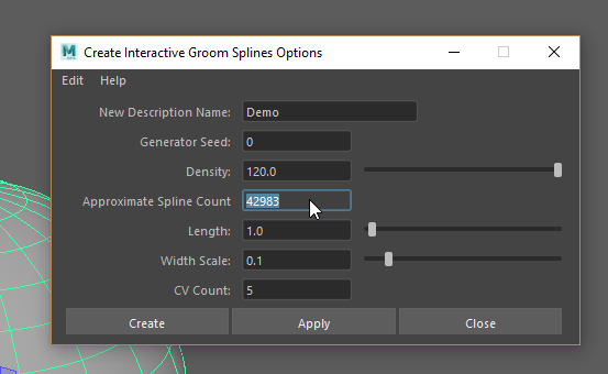

There is a counter that gives you an approximation of the number of splines to be generated for a given density when creating a description:
There is also a HUD for the grooming system that will tell you how many splines there are in total, along with the number of splines in the currently selected description and the overall memory usage
If you turn on the HUD in your current scene, you'll see how many splines you have using the multiplier. If you then delete this and make a new one, you can set the density that gives you an approximate count matching the old one then you would not need to set such a high multiplier, which does have a higher computational cost than just using a higher base density.
Remember that density is dependent on surface area as well, and a given density will result in different numbers of splines for objects with different surface area.
