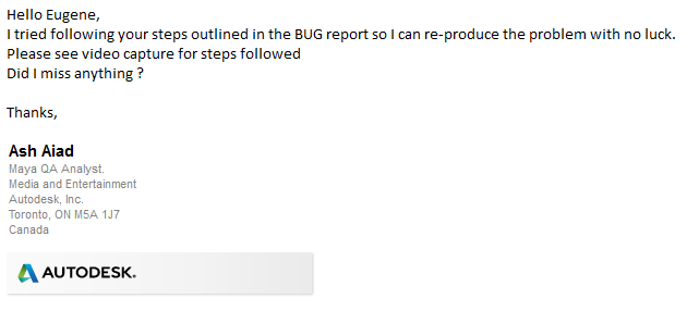

Yes, but with no result(((
Here is answer to my bug report:
Please send your reports here: http://download.autodesk.com/us/support/report_a_bug.html?SelProduct=Maya
We have to show that many people has this problem.

So what does the video look like? Did he do everything correct? Honestly I wonder what could be done wrong...? Simply the case is to a "." character in attribute editor especially. Nothing really fancy... or maybe I missed something?

Yes, the problem is in the sign ".", here is a video from support response:
