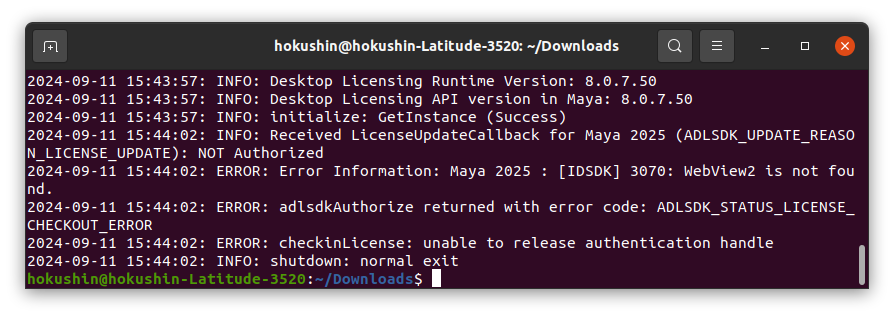

But when I try to register the installed Maya app using my Autodesk ID I get the following error message in terminal:
Screenshot from 2024-09-11 15-44-25.png Here is content of the log file:
WebView2 is not found.
WebView2 is Microsoft library and is not currently supported on Linux. How can I fix it? Is it possible to install Maya (any available version) on Linux Ubuntu machines? Is there any workaround to bypass WebView2 requirement? Any help is appreciated.

To get passed the 3005 "SSO client" error. The Identity application also needs to be installed.  You will need to cd into the ./Packages/AdskIdentityManager
sudo alien -vc ./*.rpm
sudo apt-get install ./*.deb
after this install we are back to seeing the webview2 error.  I'll ask around on my end and try to get some answers.

Yes, same on my end. I've also started receiving the (3070) error message after installation the Identity application.Screenshot from 2024-09-16 18-57-05.png
2024-09-16 19:02:47: ERROR: Error Information: Maya 2025 : [IDSDK] 3070: The PC have not installed WebView2
WebView2 is not running on Linux yet... Looks like identity manager identifies Ubuntu OS as Windows...
