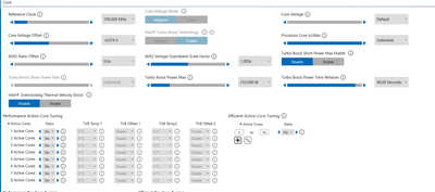

Hello, I was able to change some settings from what I saw on internet, in intel ETU and also in the BIOS, but I still have crashes. I can see my CPU temperature getting higher and higher, and then a crash.
Now it doesnt crash anymore with the sphere scene, just with my mecha scene with an area light and a skydome, 1080p.
