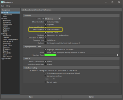

Hi @amaterasu-qbb
 -we have option to full screen Maya by unchecking show title bar
    save the preferences then relaunch Maya
-I tried it with Maya 2020.1 the task bar still shows-up but no need to relaunch Maya
-since  Maya needs relaunch to get full screen  we can't assign a keyboard shortcut to this option .

I'm sorry. I was wrong.
The moment I unchecked the show title bar as you said, the title bar just disappeared.
But when I started Maya again, the application window became a full-screen Maya window (toggle window).
If you usually close the window from the title bar,
Use Alt+space to select the bottom of the screen or Alt+F4.
