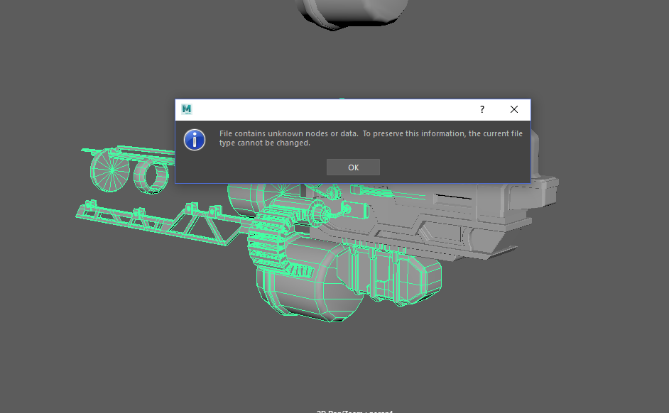

zombiejump2012
Hi
My boyfriend's maya scene has the same problem, I've tried to change nodes name, or assign different shader none of it seems work. The mesh can be duplicated in order to edit. In addition, the scene cant be saved as mb file neither.
Message 4 of 8
mspeer
Hi!
I can't help further without a scene-file.
The second problem is because of a missing plug-in that's needed for some nodes to enable a proper conversion of the used file type.
Load (maybe install first) the required plug-in or simply delete those nodes.
