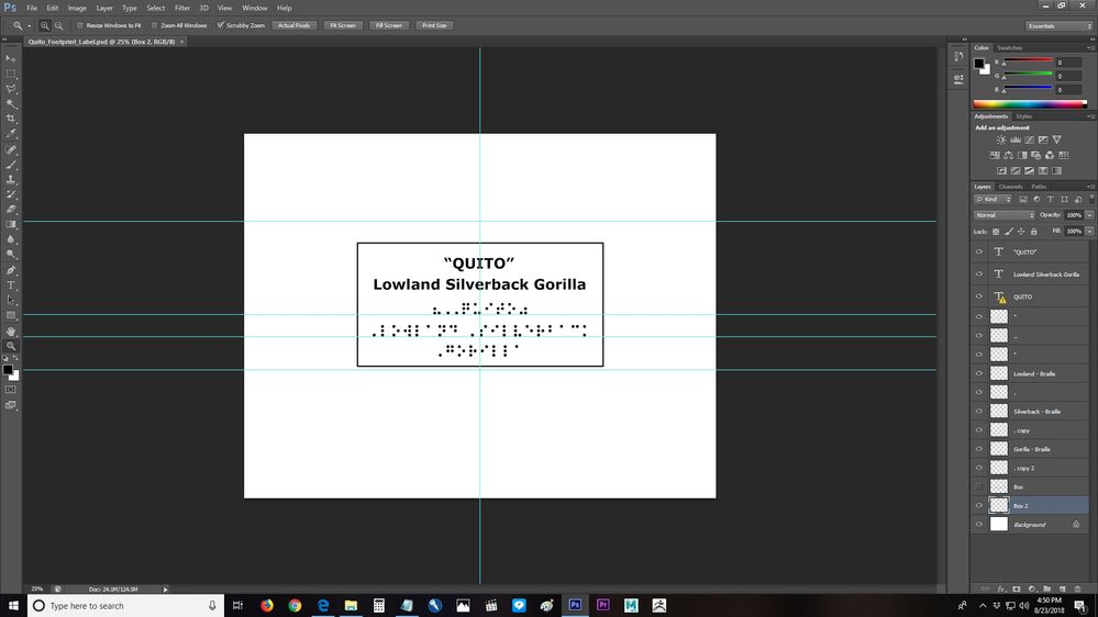

Wow. Another great video. The reason your type is not exactly the same is that I begin and end QUITO with codes for quotes and all-caps. The Silverback line is broken into 2 lines. I rotate the type 90 degrees so it lays on its back on top of the grid and I work in a top view. Have attached an earlier Nile Crocodile plaque.
The image plane is a great idea but I will also use the curves.
Thanks again. Good stuff.
~T.~
