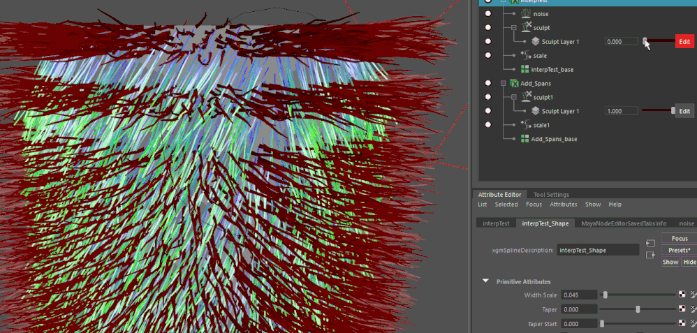

I need to modify the topology of my critter- adding a few new edge loops, retoping the nose which means making new polyfaces.
When I transfer the groom to my new mesh, it's missing fur and groom in the new faces.  I've also tried loading the previous groom as a preset but the problem persists.
I'd hate to have to re-groom from scratch every time I add or remove polyfaces....is there anything I can do?
Thanks again!
Michael_Todd
Create a new, empty description (density 0)  on the mesh and use the old description (or the transferred description) as an Interp source for the new one.
On the descriptions base node activate the density brush and select the Set operation. Set the density value you want then hit the flood button to increase the density across the mesh using the old description as the interpolation source.
The new sculpt nodes from the original will be lost, but you can carry on from this point with new ones as well as any other modifiers.
We plan to make sure that adding spans will add interpolated hairs automatically in the future..
