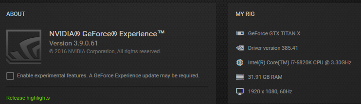

I've been trying to learn some basics of xGen. I know once you place guides, you can right-click to copy paste guides. However, when I go to paste, the first guide disappears and the second guide never shows up. Then I try to select other guides, and Maya consistently has a fatal error:
Specs:
I updated my GeForce driver today as well too...
Thanks in advance!

Michael_Todd
I can't replicate this at my end. What kind of video card do you have, out of interest..

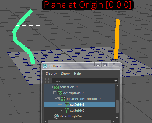

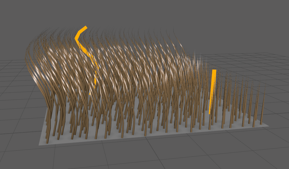

I can reproduce 2 cases where this exception happens.
1. If you paste a guide copied from an other guide on a simple plane placed at scene-origin [0 0 0].
2. If you copy and paste a guide onto itself (not useful, but can happen). // This should be reproducible in any case
This bug can easily be fixed with an if...else statement that just skips calculation of "rot" if both guides have the exact same orientation (axis is <<0,0,0>>) and there is no need to calculate new "local" positions for the CV's.
I have done this for me and now it works fine in every case.
@Anonymous You say that for you all guides disappear if you do one of the following?
Example 1:
Example2:
