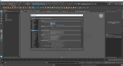

When I go to create a new nObject cache Maya automatically crashes.
The scene I'm working with is very basic as it's a learning exercise for students. It's just a standard sphere (default size) instancer attached to a nParticle. All default settings through out.
The instancer will work great, the nParticle will work great, but when I go to cache it will instantly crash Maya.
I tested it on a few older version of Maya that I have access too with no issues in 2020, 2021, or 2022, but it immediately crashes in 2023 and 2024. Does anyone have any ideas on if there is a new setting that needs toggled for it to work properly?

Are you allowed to upload your scene file?  If not, try change Evaluation Mode from "Parallel to DG and see if that fixes it.
laura.osteen
This worked! Thank you so much! (And I would have if school policy allowed).
