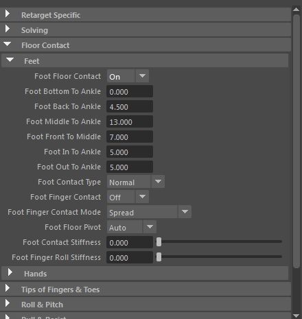

I'm pretty new to Human IK and I'm trying to change the height of the floor plane, or better yet connect an actual plane to HIK so that I can adjust it interactively.  I saw this old youtube video, but it looks like the attribute he links to no longer exists:  https://www.youtube.com/watch?v=l9cLzRk-eWY   Is there a new way to do this? I can find nothing in the documentation....Human IK seems to be pretty sparsely documented in general.  Thanks for your help.

Go to the definition tab then select the blue button, there should now be an option under 'Edit Character definition' > 'Edit HIK properties' 🙂
Hope that helps!
MRAnim8or
Thanks, I've been to that screen though.  Its a pretty big menu, maybe I'm missing where you set the ground plane in it.  There's a submenu called Floor Contact, but in it all you can do is turn on Floor Contact and tweak several of the options. As far as I can tell you can't assign a specific nurbs plane as the floor or specify the height of a floor plane.
