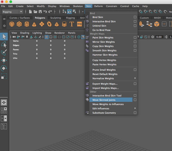

I am new in Maya, but I encountered a big problem.
The question is that I wanted to change the position of the joint after skinned without changing the shape of the model.
So I searched the information on Google, they said I can use the tool of "move skinned joint tool", but I can't find it on menu.
(I use 2017 version of Maya)
I wonder to know how to unbind the model and the bone so that I could move the single joint?
Also, the adjustment will not remove the skin weight I set before when I bind them together again.
Really appreciated for your help and kind reply.
Thanks.

kirbysteele
Hey youe.shih,
In answer to your first question, the move skinned joints tool is located under the Skin tab. The trick is that you need to have the dropdown (right below the file tab) in the top left set to rigging. I attached a screen shot.
In answer to your second question, once you "unbind" a model you are by definition getting rid of the skin weights on the mesh. But you can save that information by using the export skin weights option. This will export an image file for each joint which saves the skin weight information. Then you can unbind the mesh and move the joint to wherever you want, rebind the mesh to the skeleton and then use the import skin weights tool. I attached a screen pic showing where there tools are located. I will say that I have had mixed results with this method, but it is possible.
One last trick you can do is to simply create a new joint at the location you want and add the new joint to the original skeleton. After doing this you can use the add influence tool and copy the skin weight information from the old joint to the new joint. After there is no more skin weight on the old joint you can use the remove influence tool and then delete the old joint.
Hope this helps!

I probably used the wrong language when describing the "Rigging Tab". It is actually more of a dropdown menu and I should have highlighted it in the first post. This is the dropdown that you need to switch to rigging because right now it is set to modeling then you will be able to find all the tools you need.
Also if you hold down the spacebar you get the full tool selection panel and you can navigate to the right tool using that if you want.

Dear kirbysteele,
REALLY THANKS for your detailed explanation.
I FINALLY found it on the menu!!!!!!!
Now I can continue my work and try to modify the joint..... really appreciated the help Smiley Very Happy
