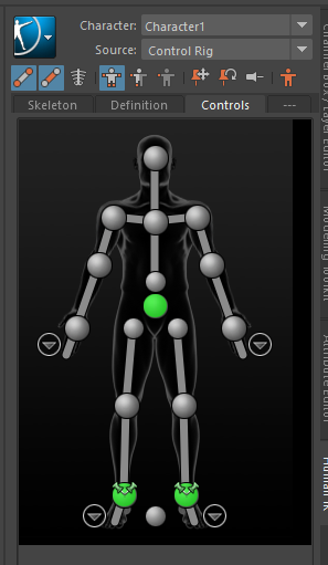

FIK means Fullbody Inverse Kinematics. Which basically allows IK to work with the whole body. As you can see in MotionBuilder and Maya Quick Rigs; if it's in "full body" controller then the whole body reacts to every movement you make. Like, if you pull the hand too much than intended then the body will follow the hand as would happen in real life.

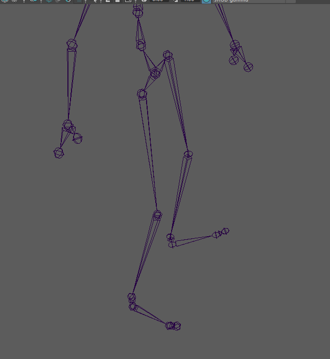

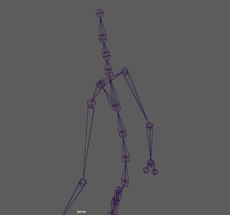

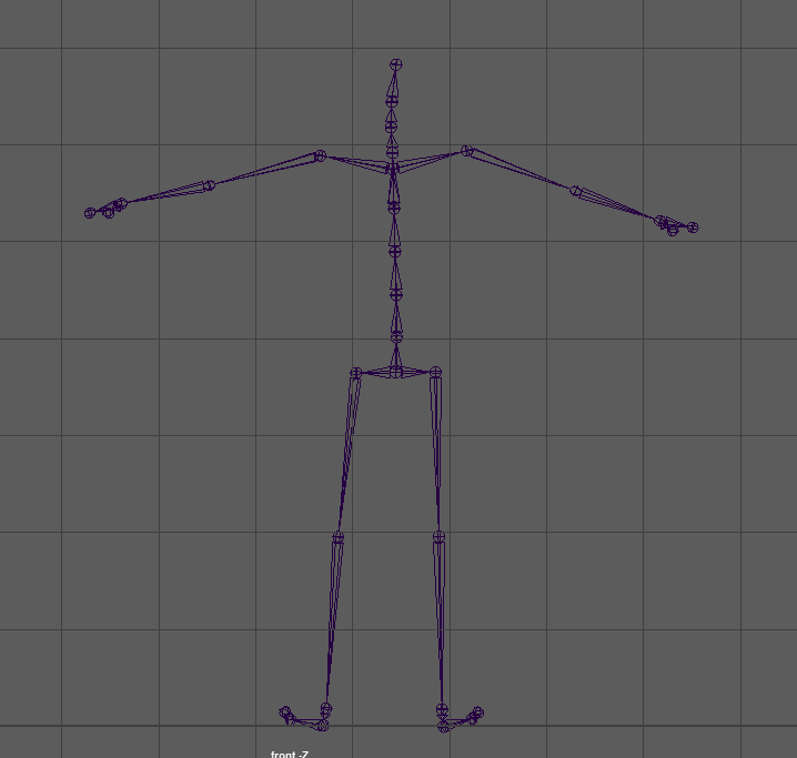

Thank you! I also recently found out I should have the same amount of joints in my rig as the mocap skeleton has
Main issue is that most of the IK foot rigging does not have that extra joint in the foot, nor do they have just one clavical(?) joint on the chest, but rather two places closer to the shoulders.
Following these tutorials
https://www.youtube.com/watch?v=WxogLUq1rd4
https://www.youtube.com/watch?v=WkKx9ijydjk
https://www.youtube.com/watch?v=Pj6TrmxhPew
Is there any way to rig as I am more used to or should I try to rig using the same amount of joints as the mocap skeleton has ?

Even though it would be ideal but it's not mandatory to have exactly the same number of joints in the skeleton. One thing to keep in mind that your target rig should have all the necessary joints in the right place to mimic the source/mocap rig. It doesn't matter if the numbers don't match. you can see the ideal rig set up in the quick rig setup.q.PNG
