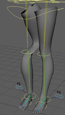

I was following Antcgi's rigging tutorial https://www.youtube.com/watch?v=4cBlRF_dr90 , but arrived  at some issues when switching between FK and IK after binding skin.
The rig who is not being used at the moment of the bind skin becomes deformed, so I was wondering if there is any solution other than redoing the rig.
This problem occurs on the left arm and the right arm which was mirrored and the controls duplicated and flipped, however while the mirroed leg rig is also deformed when switching, the original left leg rig becomes just slightly  deformed. While I clicked on the main rig system to bind skin the IK was the one selected
The IK rigs are a bit off-position than the FK rig, I believe that is caused because of the ik handle or pole vector, but even so the orientention of the joints and position aren't so off that it deformed the rig that much.
I don't know if it makes any difference but all the bind methods give the same results.

"The rig who is not being used at the moment of the bind skin becomes deformed"
That's a bit unclear what is actually happening.  Rigs usually don't deform other than maybe the controllers?  It's the mesh that gets deformed by the rig.  So that isn't clear from your statement.
I didn't watch the tutorial.  But how a switch is supposed to work is you have an IK result and an FK result.  And the switch allows you to blend from one to the other.  Now you're correct in that if there's a mismatch in the FK and IK joints, you will see a slight deformation change between the 2 states.  And this is usually caused by the pole vector on your ikHandle.  I'm assuming you duplicated your FK joints to create the IK joints or vice versa.  But in any case, the 2 systems should have been in sync at some point.  The last image of the shoulder joints is odd in that it appears the local rotation axis is different between the 2 joints.  Or did the joint orient values get changed somehow?
This is also unclear what's happening.  "While I clicked on the main rig system to bind skin the IK was the one selected".  Did you bind your mesh to your IK joints?  Maybe in your case to keep everything clear, you should have 3 skeletons.  An FK, an IK and a bind skeleton.  And obviously bind to the bind skeleton and create your switch/blend with your FK and IK as the inputs and output to the bind.

Sorry for the confusing post, I have 3 rig systems for the arms/legs, the IK one, the FK one, and the main one that I selected to bind the skin.
I meant to say that on the fk/ik switch controller, if the value is set to 0 (FK) while I select the main rig and the mesh and then bind the skin, the FK joints/controllers work fine, but if I switch to the IK controllers, the mesh becomes deformed.
The FK/IK orientantion seem to be both the same,so much so that it seems to only show the axis for only one of them, and the main rig joint is slightly tilted.

Take note of the rotation values of your main joint that is deforming strangely.  Set your switch to FK and note the values.  Then switch to IK and note the values.  They will not be the same.  You will need to compare your FK joint with your IK joint to determine where the mismatch is coming from.
You might want to do a simple test of duplicating your FK limb joints and creating an ikHandle on the duplicate and see if it matches the FK.  Maybe something went astray when you created your ikHandles.
Also, just looked again at your original images that you posted.  In those images, the FK is the one that has the problem...at least in the legs.  Usually, it's the IK that would have issues if something went wrong.
