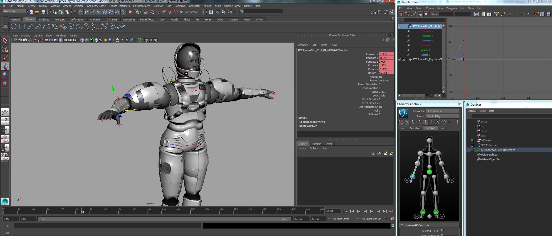

I have a problem animating the HumanIK rig. I created one and animate it using keyframes. The problem is, that everything works find besides hands. The just do not animate. I change the position, the key is created, even the translate and rotation values change in time but the hand stays still in the position of the last keyframe. Any ideas? Legs, body and head works fine, the rig seems to be proparely attached because the hand is moving, it just stays at the point of the last keyframe.

I looks like that:
This is first frame, it have a key frame, so here is next frame, 54 which also have a key frame and the translate and scale changed but the character stays in the same position.
It applies to all arm and hand controlls, all body and legs controllers works. Any ideas?
Ok, so I've found a temporary solution that works (but I still wanna know, why isn't that controlls animating, watched like 10 tutorials and in every one it worked).
So, my solution was to add aux effectors to hands (under number 1 on the picture, click right mouse button and creat aux effector). I could then animate it, as well as leave it at certain position on the ground so I fixed two issues).
ashyankee
Thanks a lot! I had the same issue. Everything else animated except the hands/wrists. Creating an AUX controller worked. Don't know why it happens though.
