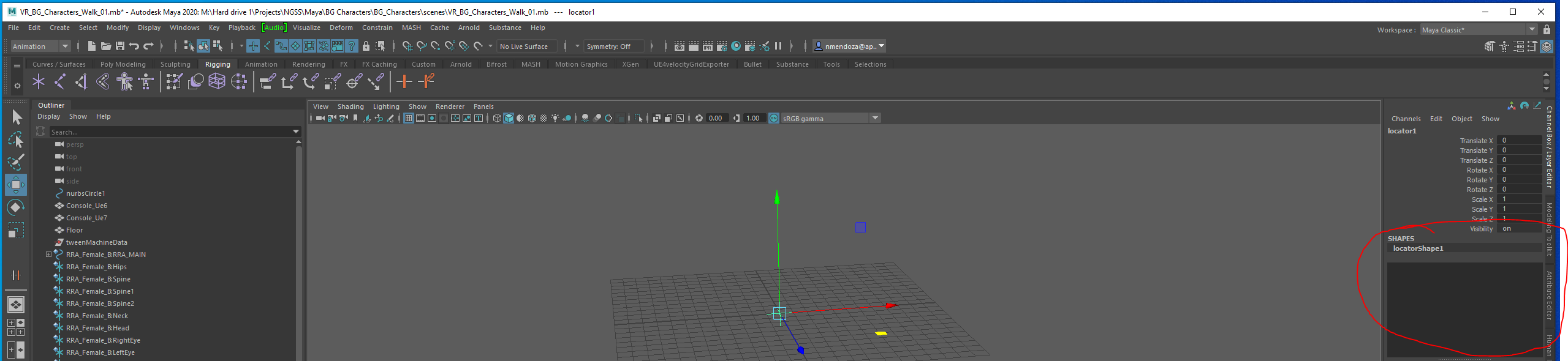

I am using maya 2020 and noticed that when I put a locator in the scene I can't control local scale in the shapes section under the translate, rotate, scale, visibility, like I was able to in maya 2019.   Why is this?  I needed the local scale to make some bigger when I need to see them in a mess of objects in the scene.  And I don't want to scale it up if I need to parent something to it, but want it bigger to see in the scene.

nmendoza
Maybe these pics will help.
