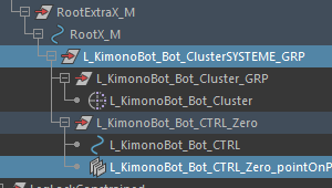

So I attached my rig and it would be really amazing if you could explain why it doesn't work 😞
on the image I circled all my clusters, but the one marked 1 is the one I completely redid as the same way I explained. The other ones are with my different workflow (that still doesn't work hahahaha)

All clusters are behaving with the exception of the one you indicated.  And that one was also working based on how it was driven.  What needed to happen is on the "GRP" node in the attached image, there is a scale of 37.  That means your "CTRL" has to move 37 times farther than your cluster.  Reset the scale of the "GRP" to 1.  Then the only other thing is the pointOnPolyConstraint.  That is causing a double transform resulting in your "CTRL" being much farther than your cluster.  I zeroed the weight of that constraint and the results were much better.  I hope that makes sense.  Good luck with your project.

fix.pngOOPS, forgot to attach the image

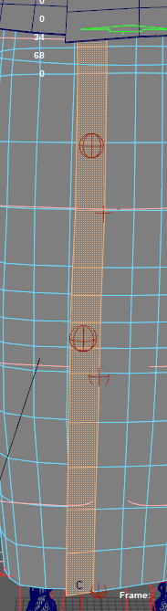

strip.pngThere's a lot going on in your setup so I don't want to dive too deep.  A quick solution to your "double" transform with the pointOnPolyConstraints is to use a proxy mesh to constrain to.  This will allow you to position your CTRLs but not double transform them.  In the image, to create the highlighted strip, duplicate your mesh at scale 1.  Extract that strip from the duplcate mesh.  Now copy the skinning from your original mesh to the strip.  Use the strip as the source for your pointOnPolyConstraints.  And then hide the strip.  No clusters on this strip.  Only the skinCluster.  I hope that makes sense.

HOUUURAYYY! FINAAALLLYYY! I'm soooo happy! it works great! Great tip about duplicating the mesh to have the constraint on it! This is what I was missing to not have that double transform! Thank you so much!
