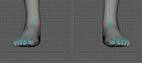

Hi guys,
I have a skinned mesh with two rigs, which I need to move down a bit as otherwise the character is floating in Unreal.
If I understand it correctly, DHIbody:root is the actual skeleton, which has a parent constraint to root_drv.
I tried moving root_drv down (which brings the mesh and the other rig with it), and then moving just the root_drv joint back up to the origin with the Move Skinned Joints tool.
That doesn't seem to be enough, as it is still floating when exporting.
Is there anything else I have to do?
Adjust bind/rest pose or something like that? I'm new to Maya.
Thanks 🙂
/Edit: I posted in the wrong forum, can someone move it to the Rigging forum?

ppGRHWT
Thanks!
The problem was actually an import issue in Unreal.
Somehow, when overwriting an existing skeletal mesh, it didn't update the transforms properly.
Everything worked fine when deleting and importing from scratch.
Moving the whole rig is even easier than I describe in my post, you can just move pelvis_drv down and it's done.
