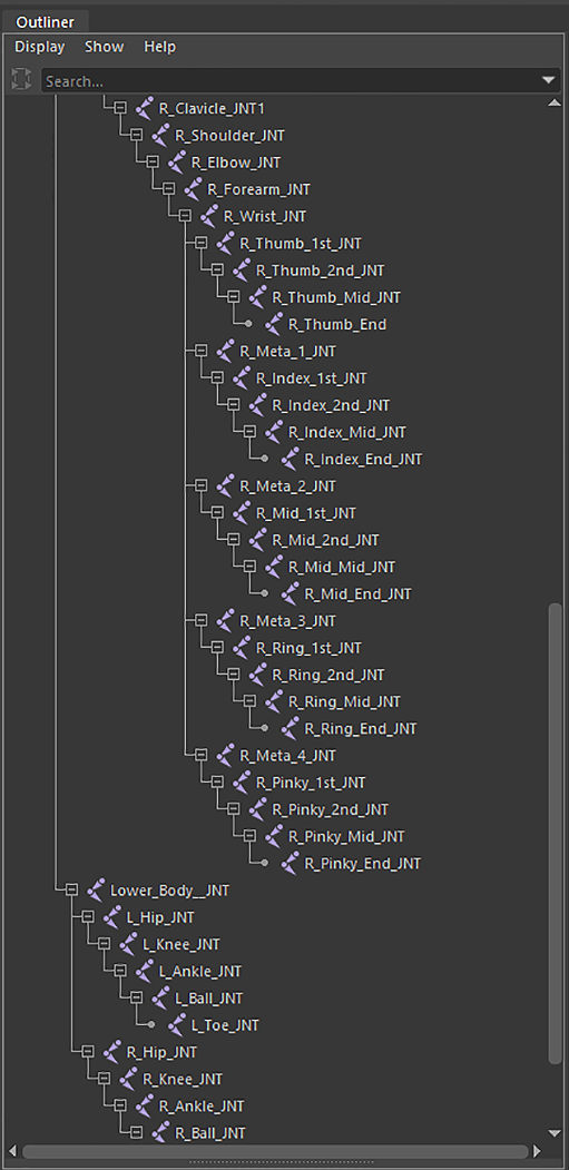

Attached are 3 outliner images regarding my rigging question.
This biped character will do only basic things; walk and do some rock climbing.
 I know there are many ways to arrange a characters joint hierarchy,
 but does this one look basically ok ?
I will be adding controls next, but wanted to see some reactions first.

Hi!
The hierarchy looks good, I'm not quite sure what the "Meta" Finger joints are, but depending on the setup you have in mind I'm sure they make sense. 🙂
The only thing I see that you could change, is that you forgot to delete the 1 at the end of "R_Clavicle_JNT1" after you duplicated it from left to right.
