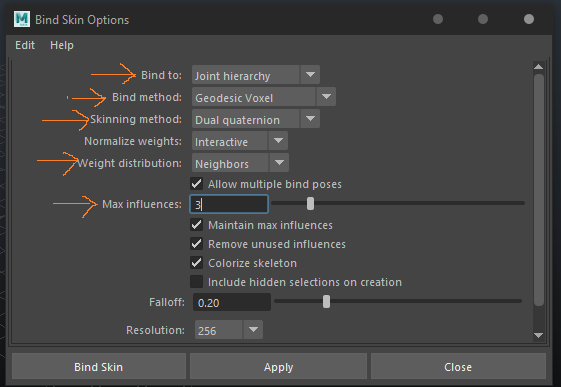

gautham.chandran47
Follow these settings to get the best results without editing the skin weights.Screenshot (95).png

This isn't answering my question. I WANT to do the weight painting, I don't want Maya to give me approximate results.
