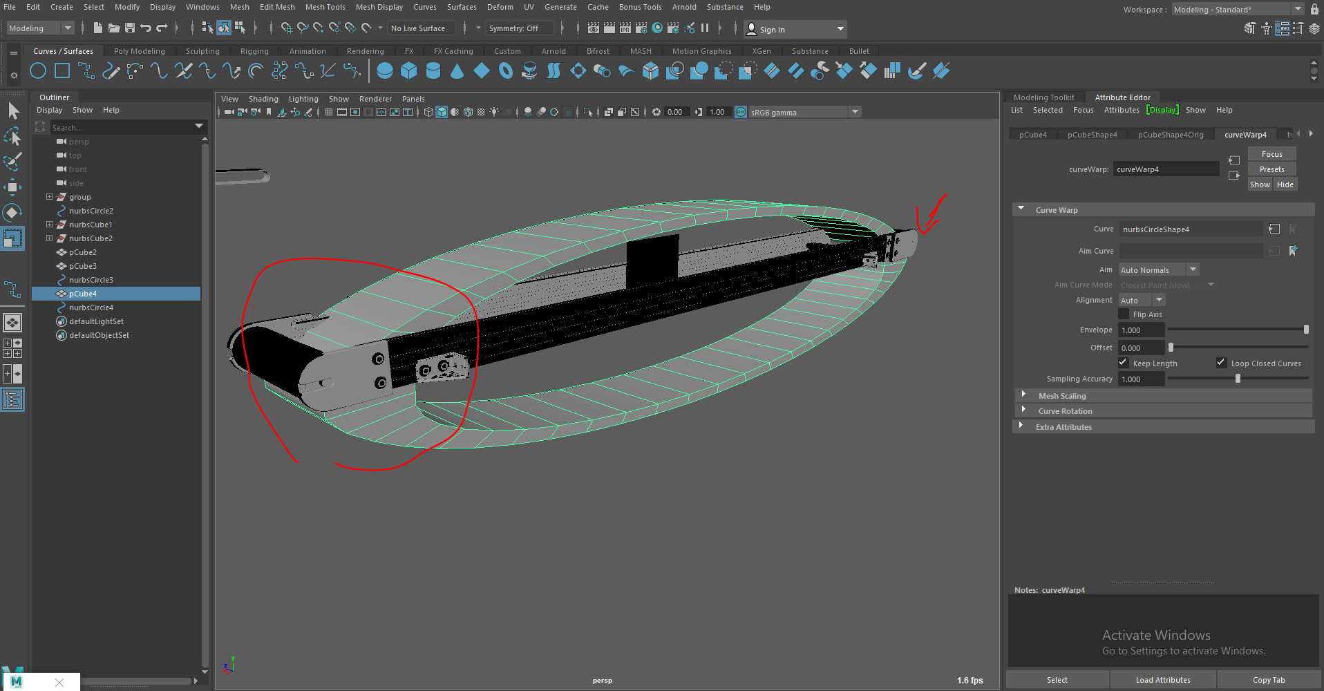

Hi so I am new to this what I am trying to get is a Conveyor belt animating just like in the supermarkets/factories the thing is I am trying to roller it on its y-axis just like rotating without moving I tried a lot of things
1.change pivot place didn't work it still moves to other sides
2.tried freezing translate pivots didn't work it didn't change anything
3.adding wire and make it rotate I followed this tutorial https://www.youtube.com/watch?v=Hu4-XTNbV0s I arrived to this point where to change "dropoff distance" but it seems it ain't there
A tip I didn't find output so I clicket input
(if u could find another solution to make this type of animation plz don't hesitate to tell me)

The conveyor belt and its rig could be made within 5 mins.
1. Create pCube, make Width 10, subdivisions Width 50;
2. Create Nurb Circle, set Sections to 16, rotateX 90.0 ;
3. Select both cube and circle and go Deform>CurveWrap - the cube will wrap around the curve; enable LoopClosedCurves;
4. Move and reshape curve to fit the contour of the conveyor;
5. In polyCube node extend the Width so the both ends meet, decrease Height to some 0.1, make conveyor-wide Depth, add divisions, if necessary;
6. in the CurveWrap options animate the Offset param to get the belt sliding.
The only tricky part is the orientation of the curve, you won't be able to tilt it in one axis (here -X), therefore plan ahead the correct orientations.
Presto!

Quite contrary, it is BETTER than before, the geo is good, the curve still seems scaled, even if you have scaled CVs X axis, this is not fitting your conveyor, obviously. If you followed my notes, then there should be sufficient number of CVs to accommodate two wheels and still have some left to control the section in between.
If it is not enough, then you can Modeling>Curves>Rebuild[options], or redo everything (which is not THAT much) from scratch, just with even more Sections on the circle.
And, you obviously have accessed PolyCube node before, set the Height attribute to something small, the cube will resemble a tape (for its settings, see my initial screenshot right in the middle).

You were doing this fine, except, what I said about scaling - you don't! - neither polyCube nor nurbCircle. And you did not increase the number of the circle segments, the default 8 can be to little to wrap around the wheels.
Did you try to press F8 key with curve selected? Alternatively click those buttons:
There you will enter curve editing mode - reshape the curve in the Front view. See approximate CV arrangement in my previous screenshot.

The curve you have made is little of use, because your tape won't be that thick, and the ends are not round. Just ignore the size of cube for now - if it confuses you, hide it, hide everything, except those two rolls at the end of conveyor frame, - and reshape that wretched curve, for which you don't need that insane number of CVs, the less is more. I've even made you an example with 16 CVs, why can't you just copy those approximate positions to your CVs? Snapping to grid helps a lot.

I made it like what I wanted and tried changing offsets and keyframing them still it didn't get keyframed, the offest is working but not the keyframes taking any change  any idea how to animate it in a scene
Message 20 of 23
hamsterHamster
Works totally fine for me here. The curveWarp.offset is limited to 1.0, yet you can enter any larger number. Also don't forget to enable curveWarp.loopClosedCurves.
