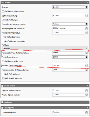

also you have to select this in the cam:
sorry for the german text ... can't restart now to change 😄
This option is realy fast if you don't have large bevel edges. The calculation starts only at every 39mm and all flat areas will be milled afterwards. If you change the second 39mm to .. e.g. 1mm (Fine Stepdown) the calculation will be done at every mm and takes hours for a large part.
