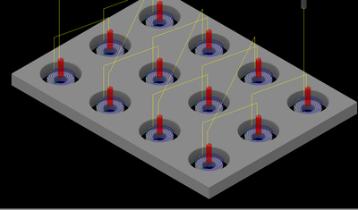

How does one cut a component from a material sheet? The component looks this way Capture.PNG
I mean, Inventor does cut the holes nicely. But it assumes my media has got a rectangular shape at that size. I, on the other hand, use a piece of plastic way bigger. How does I command Inventor to cut the edges? Otherwise, I will simply cut holes.
Also, how does I automate the process to work multiple times? Let's say, I want to print 5 of it, can I just make the drill bit to move to another position and re do the entire process?

You can just use a 2D Contour to cut the piece out of the sheet.
For doing it multiple times, you can or use a pattern or multiple work offsets in the set-up and machine.

Hi! Thanks! I'll try it.
Also, I noticed that the lower or the inner part of the well is not drilled.
Do you know what I should do?
