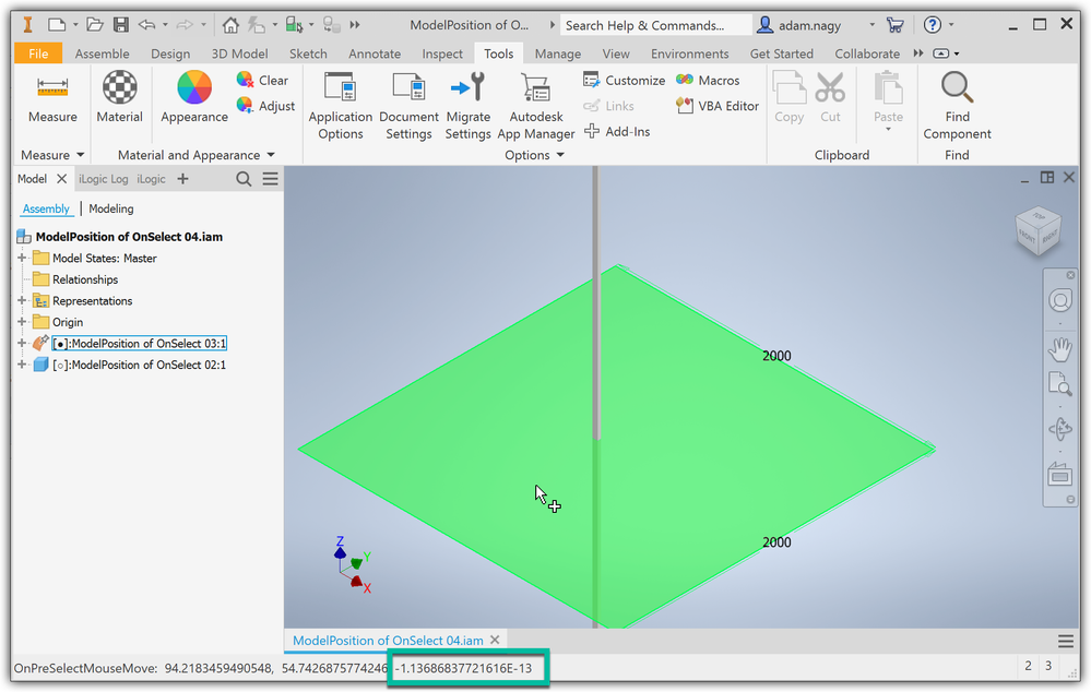

how do I make the ModelPosition of InteractionEvents.SelectEvents.OnSelect to be on the clicked ComponentOccurrence, if there is a Boundary Patch in front of the ComponentOccurrence?
I use the InteractionEvents.SelectEvents.OnSelect to select a ComponentOccurrence and get the ModelPosition of the mouse-click on the ComponentOccurrence (SelectionFilterEnum.kAssemblyOccurrenceFilter). The ModelPosition is the correct mouse-click position on the ComponentOccurrence as long as there is nothing in front of it. But if there is a Boundary Patch in front of the ComponentOccurrence, the ModelPosition seems to be the base point of the Boundary Patch.
Am I missing some kind of setting to get the ModelPosition on the ComponentOccurrence?

Both values (Select and PreSelect) in the picture you provided seem to be on the bar (extruded part):
Any point on the occurrence of the boundary patch would have a Z with some kind of numerical representation of 0 (inc -1.1xxxE-13)
The ModelPosition value of OnPreSelect provides the position of the mouse when it first hits the object, whereas the value in OnSelect is when the left mouse button got clicked - that's why they can be different.

You are correct, that the ModelPosition can't be on the BoundaryPatch (would be Z 0), but it seems to be the Center Point of the bar, if the bar is clicked where the BoundaryPatch is in front of it. Note, that I only set DoHighlight to true in OnPreSelect, if the ComponentOccurrence is the one with the bar ("ModelPosition of OnSelect 02:1"). The VBA Editor has correct values for the ModelPosition (see attached zip), but the ModelPosition in the C#-Addin doesn't.
Screenshot of the ModelPosition of the C#-Addin and of the measurement of the Center Point of the bar:

You don't need this - that seems to be causing the problem:
MorePreSelectEntities = _CommandManager.Parent.TransientObjects.CreateObjectCollection();
MorePreSelectEntities.Add(PreSelectEntity);
Not sure if it's a problem for you, but in this case, the ModelPosition in OnSelect will be the same as in OnPreSelect if the mouse button is clicked in the area where the bar is behind the boundary patch.
If instead of driving the value of DoHighlight in OnPreSelect, you restrict the selection to a given occurrence using RestrictSelectionToOccurrence, that seems to have the best result.
