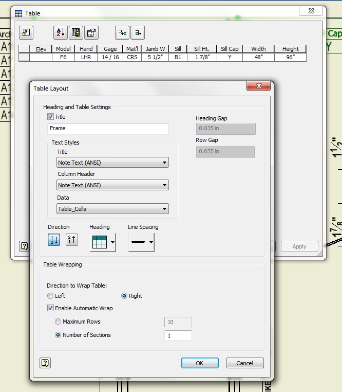

I have a customtable that is created within a .idw, and I would like to have the data cells set to "Table_Cells" style that I have created.  I cannot find anything in the help file with a sample code to build off.
I figure it's got to be something with oCustomTable.DataTextStyle but beyond that I am lost.

This is what I'm trying to set (forgot to attach the picture)
