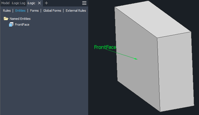

The subassembly includes a part component Part_01:1 with an assigned entity name FrontFace
Now I can add a constraint in the top level assembly using iLogic:
Dim oComp1 As ComponentArgument = "" 'empty string for root component
Dim oComp2 As ComponentArgument = "Sub_01:1" 'string for first level component
Dim oComp3 As ComponentArgument = {"Sub_01:1" , "Part_01:1"} 'array of strings for subcomponent
Constraints.AddFlush("Flush1", oComp1, "XY Plane", oComp3, "FrontFace")
In this case the XY Plane of the top level assembly will be constraint to the face named FrontFace of the Part in the subassembly. See the comments how to create a ComponentArgument-Object using an empty string, a string or an array of strings.
