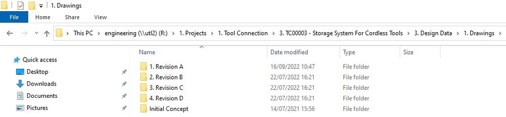

OK.  So you need a 'recursive' sub routine that will process every level of the main assembly, and every level of every sub-assembly, opening every drawing for everything possible, right?  Well, if the model files and their drawing files are not located in the same folder, how can we know the exact path of the folder where we can find the drawings?  Is there always a sub-folder just for drawing files, just under every folder that holds model files (and if so, what is that sub-folder's name?)?
Wesley Crihfield
(Not an Autodesk Employee)
Message 7 of 10
gareth.butlerS9R7M
Hi WCrihfield,
"OK.  So you need a 'recursive' sub routine that will process every level of the main assembly, and every level of every sub-assembly, opening every drawing for everything possible, right?"
Correct, although I see your point now in terms of knowing the folder reference paths!
I think this might be asking a bit too much as it is multi-level / multi-folder.
You are going to love me for this, but hopefully the attached images will kind of explain the folder structuring.
Drawing Folder - Project TC00001.jpg3D Models Folder - Project TC00001.jpgDrawing Folder - Project TC00003.jpg3D Models Folder - Project TC00003.jpgDrawing Folder - Project TC00003 - Revision Level Sub-Folders.jpg3D Models Folder - Project TC00003 - Revision Level Sub-Folders.jpg
Many thanks,
Gareth
