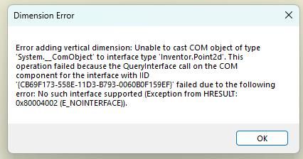

Unable to cast COM object of type 'System._ComObject to interface type 'Inventor.Point2d'.
SPalchaudhary
162 Views
SPalchaudhary
Hey, so I am trying to create an ilogic code for my organization which would help us in automating drawing of simple flat mounting plates, I created my ilogic code for the same but seem to run into an error while executing the drawing, can somebody help me figure out, how can I resolve this?
224e580c-e6ff-40ea-a91e-6ebf104d16a5.jpge6527a1a-dbf6-46be-b154-ab30309fb8ff.jpg8e002582-59c2-420d-a0a7-7cd41485745b.jpg
Below is my current code:

        Dim dimPointV As Inventor.Point2d = tg.CreatePoint2d(baseView.Position.X - (baseView.Width / 2) - 2, (minY + maxY) / 2)
        Try
            oDims.AddLinear(bottommostCurve, topmostCurve, dimPointV, Inventor.DimensionTypeEnum.kVerticalDimensionType)
        Catch ex As Exception
            MessageBox.Show("Error adding vertical dimension: " & ex.Message, "Dimension Error")
        End Try

cidhelp
Hello @SPalchaudhary ,
the Syntax of AddLinear needs the TextOrigin first. Second argument must be of type GeometryIntend:
https://help.autodesk.com/view/INVNTOR/2023/ENU/?guid=GUID-15004C1C-821E-4ACF-981E-5ACC08E3EB65
SPalchaudhary
Hey, lemme try and change that and let you know
