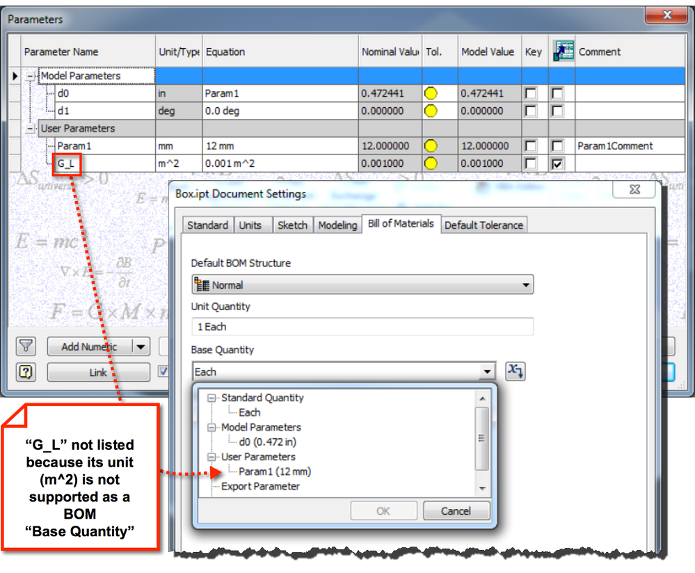

Area is not currently supported as a Base Unit for BOM. This has been logged on the IdeaStation - even though it has been accepted it could be useful to vote on it so that it will get implemented sooner:
http://forums.autodesk.com/t5/inventor-ideas/area-units-in-base-quantity/idi-p/4387795
You can see the supported units in the dialog:
As I said you can work around it but not sure if this will cause issues down the line 😕
1) create a parameter with a supported unit
2) set the BOM base unit to be based on this parameter
3) now change the unit of the parameter to an area type >> the BOM base unit will be the same
