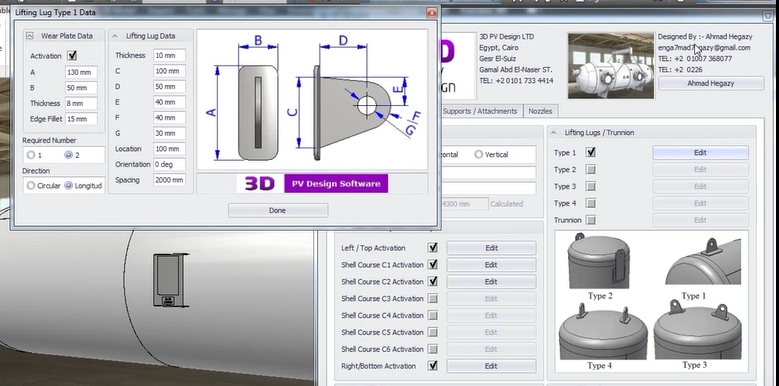

I am a beginner at illogic, so I don't know how to do this specific task ( I hope I can explain it properly).
I have a main assembly that contains several sub-assemblies.  I want to be able to have a form in the main assembly that will open the sub-assembly form when I need to edit the sub-assembly.
The attached picture is similar to want I would like.  The user has an the "EDIT" button in the main form that opens the sub-assembly form and then modifies the sub-assembly by changing values / suppression / etc.
How is this done ???
Any assistance would be appreciated.

rikard.nilsson
Test this.
In main assembly use iLogicVb.RunRule(“componentName”, “ShowFormRule”)
In subassembly use the snippet ShowForm(“formName”) in a rule called ShowFormRule
/Rikard
doug.johnston
Works perfect ... thank you !!!
