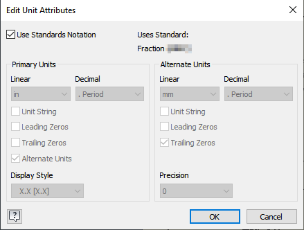

I checked the settings, i do not see anything for Retrieved/RetrivedFrom. Right clicking a leader and going into "Edit Unit Attributes", it uses Standard Notation. I personally just don't see anything though. I attached a few photos just in case someone else sees anything.
