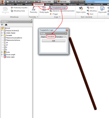

@Tabla100: Go for the Manage TAB and once you will open the iLogic Browser you will find a SIZE form in every file that will be created from the template I create. I wrote you before where to put this file.
Open the form and play with it. Have fun.
