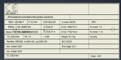

I'm trying to insert a DFX file into a sketch of a part file, Unfortunatly not everything in my DFX file appears.
I think some layers are missing or something.
Here is my DFX when i open it
Here is the result in the Part file

Daan_M
@JelteDeJong Thank you for the advice.
I added the following line in my code, but still only the text gets added onto the .ipt file and not the lines:
oOptions.Add ("SelectedLayers", "0")
When i check the .dwg, the layer with lines should be "0"?
The same goes for the text:
I attached my .dwg file.
Curious what i'm doing wrong
JelteDeJong
In your OP you wrote that you wanted to import a DXF. But you posted a DWG file. On closer inspection, I discovered that the options that you use are also for DWG files. But the GUID is for the DXF translator (I did not see any import options for the DXF translator btw.) Anyway, if you want to import DWG files you need to use a different GUID.  This iLogic rule worked for me.
 Dim oDXFTranslator As TranslatorAddIn = ThisApplication.ApplicationAddIns.ItemById("{C24E3AC2-122E-11D5-8E91-0010B541CD80}")
'Dim oDXFTranslator As TranslatorAddIn = ThisApplication.ApplicationAddIns.ItemById("{C24E3AC4-122E-11D5-8E91-0010B541CD80}")
Dim oPart As PartDocument = ThisDoc.Document
Dim oPCD As PartComponentDefinition = oPart.ComponentDefinition
Dim oPlaneXZ As WorkPlane = oPCD.WorkPlanes.Item(2)
Dim oSketch As PlanarSketch = oPCD.Sketches.Add(oPlaneXZ)
oSketch.Edit()
Dim oDataMedium As DataMedium = ThisApplication.TransientObjects.CreateDataMedium
oDataMedium.FileName = "D:\forum\Laserding.dwg"
Dim oTranslationContext As TranslationContext = ThisApplication.TransientObjects.CreateTranslationContext
oTranslationContext.Type = kFileBrowseIOMechanism
oTranslationContext.OpenIntoExisting = oSketch
Dim oOptions As NameValueMap = ThisApplication.TransientObjects.CreateNameValueMap
oOptions.Add("SelectedLayers", "0")
oOptions.Add("InvertLayersSelection", True)
oOptions.Add("FileUnits", "Centimeters")
oOptions.Add("ConstrainEndPoints", True)
oDXFTranslator.Open(oDataMedium, oTranslationContext, oOptions, oDoc)
oSketch.ExitEdit()
