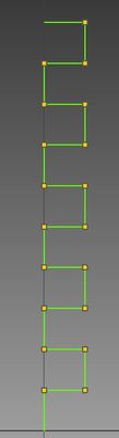

How can i rounded two lines in sketch using ilogic rule?
I have a point in Excel
Nr 1 [X,Y]
Nr 2 [X,Y]
EOF
I read this poins and create a line
first line [Nr 1, Nr 2]
second line [Nr 2, Nr 3]
etc
I want doing somting like that:
