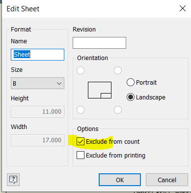

This is amazing . Is there an easy way to add the sheet 1 to the table?   I feel like it has to do with line 15, 18,and 19.
0 件のいいね
メッセージ9/18
Curtis_Waguespack
Hi @t.adkins
In the example I posted Sheet1 was set to be excluded from the count, so the code is skipping that sheet, and it is adjusting the count by -1, using these 2 lines:
oRows = oDoc.Sheets.Count - 1
If oSheet.ExcludeFromCount = True Then Continue For
To include Sheet 1, even though it is excluded, we could use something like this example below.
I hope this helps.
Curtis

Is there a way to make the sheet that the table on show as sheet one instead of "-" ?
0 件のいいね
メッセージ11/18
Curtis_Waguespack
解決済み
Hi @t.adkins
So to clarify:
You have sheet 1 ( the index sheet containing the table) set to be excluded from the count, but you want it to be listed in the table as sheet 1.
If that is correct, then something like this would work.
I hope this helps.
Curtis
