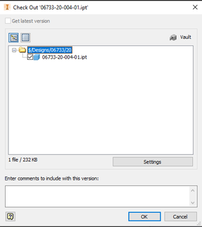

Message 6 of 22
Nejc.Leban
@theo.bot
How would I then check out a single part from the assembly using iLogic?
Like This:
Like I said, "VaultCheckOutTop" tries to check out the whole assembly, I would like to only check out certain parts in that assembly. If "VaultCheckOutTop" opens a window like the above picture (but for the whole assembly), how do I do it for a single part (like in the pictures) and what's the command for pressing the OK button?

Message 8 of 22
Nejc.Leban
Yeah, I've actually tried that and it worked for me as well, but the problem is, like you said, the number of parts. I sometimes have big weldments, consisting of 100 parts.
What about the OK button, how do I get iLogic to "press" the OK button?
Message 9 of 22
theo.bot

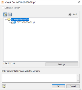

show me a screenshot. is it the check out dialog? I always have them suppressed, because in 99% of the cases i just need to hit OK . you can set this in vault options (on the ribbon vault):
Message 10 of 22
Nejc.Leban
Yeah, it's this window.
I wouldn't like having it suppressed, is there a way for iLogic to "press" the OK button?
Message 11 of 22
Nejc.Leban
OK for anyone who might need this, I've found a solution. It selects all parts with the same part of the name as the assembly and checks out those parts:
