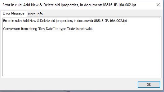

didin.suryadi6JREK
Hi Rob
sorry for hurry, he is sleeping and will read by tomorrow, so do i.
Anyway i tried with your suggestion and it looks like the string did not match,
See Attached

JhoelForshav
Hi @didin.suryadi6JREK
The only way I can get this to work is to create the property with a date, then make it Null. Like this 🙂
Dim propertyName1 As String = "Rev Desc"
Dim propertyValue1 As String = ""
Dim customPropertySet As PropertySet = ThisDoc.Document.PropertySets.Item("Inventor User Defined Properties")
Try
	prop = customPropertySet.Item(propertyName1)
Catch
	customPropertySet.Add("", propertyName1)
End Try
Dim propertyName2 As String = "Rev Date"
Dim propertyValue2 As Nullable(Of Date) = Date.Now
Dim NullDate As Nullable(Of Date)
Try
	prop = customPropertySet.Item(propertyName2)
Catch
	customPropertySet.Add(propertyValue2, propertyName2)
	iProperties.Value("Custom", propertyName2) = NullDate
End Try
Dim propertyName3 As String = "Salvagnini Proficient"
Dim propertyValue3 As Boolean = True
Try
	prop = customPropertySet.Item(propertyName3)
Catch
	customPropertySet.Add(propertyValue3, propertyName3)
End Try
Message 14 of 14
didin.suryadi6JREK
Waw,,.. Its working now,
Thank You very much sir, have a good day
