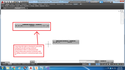

In  Autocad user can add c# code for user defined commands which user can write in command prompts and then call function of C# say  [CommandMethod("DrawTable")]  function(){}, How can i write same user defined command function for inventor which will run when user enter command "DrawTable" in inventor command prompts and from c# the defined method will run.
I have to draw table on drawing on user run command  for inventor, can you send me some example to how to draw table on drawing on user enter command for inventor using c#. Also how to trigger command in inventor.

Thank you for your solution ,
For ReferenceFor Referenceplease check the attachment for your reference.
