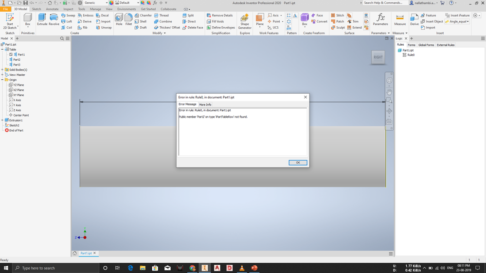

jeeva.scientist
i am getting some error
clutsa
Leave the code just like I had it for the Row.Item(2).
Item(2) is the 2nd column in the row which happens to be the part number column. Row.Item(1) is the member name column if you want to look for member name not part numbers.

jeeva.scientist
I have attached the part file can you check if I made any other mistake, please.
clutsa
It's case sensitive. Try capitalizing the names in the list or add code to force the cases to be the same

jeeva.scientist
Working proofWorking proof
thank you very much for your support Mr. Andrew Cluts.
