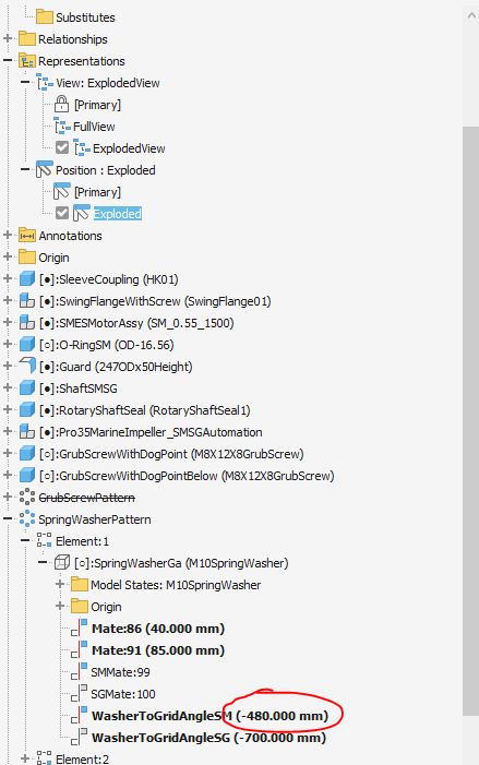

hi team,
I was working with an exploded view, and I moved some parts with values(constraint),
if the configuration changes the part constraint values also need to be updated.
I am looking for ilogic to control with a view called exploded view.
also, I have attached the image for the exploded view.

Hi @khadeerkruthi
I am almost certain you can do what you need without ilogic. You just need to overide the constraints and change the posrep. See article here. Does this get you what you need?
Regards
Alan
