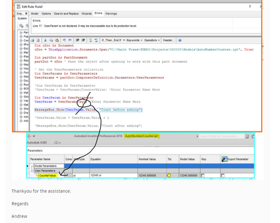

andrew_canfield
Apologise, I'm pretty certain I've followed the instructions but..
Thankyou for the assistance.

A.Acheson
Unless you have a variable elsewhere in your image you are looking for the wrong parameter name. The name if string should be "CounterValue"

andrew_canfield
Sorry, my bad, I was testing with an additional parameter called 'xyz' along side 'Countervalue' the text did read 'CounterValue' but the same error occurs.

A.Acheson
You are offering a variable rather than a string value. Hence the not declared error.
String value has the quotes.
Dim UserParam As UserParameter
UserParam = UserParams(“CounterValue”) 'Enter Parameter Name Here
If you want to use a variable string.
Dim oName as String
Dim oName = "CounterValue"
Dim
UserParam As UserParameter UserParam = UserParams(oName) 'Enter Parameter Name Here
Regards
Alan

andrew_canfield
Excellent - many thanks 🙂
Enjoyed the test too - edited to: (there was an extra Dim-second line)
Dim oName As String
