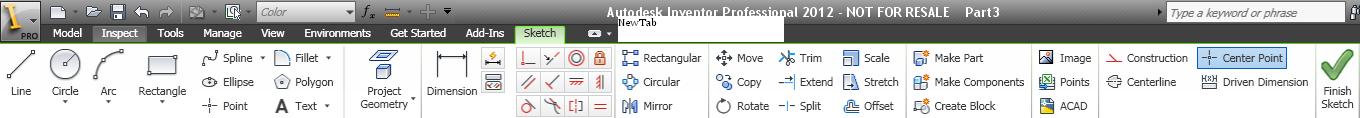

Actually i am trying to add a new tab in inventor but am getting confused of doing so. Is it possible to add a new tab to inventor using .NET

A new Tab after Sketch, this is am trying to do.

Hello
from programmers help:
' Set a reference to the user interface manager. Dim oUIManager As UserInterfaceManager Set oUIManager = oApp.UserInterfaceManager ' Get the ribbon associated with part documents Dim oRibbon As Ribbon Set oRibbon = oUIManager.Ribbons.Item("Part") ' Create a new tab Dim oTab As RibbonTab Set oTab = oRibbon.RibbonTabs.Add("My Tab", "invrMyTab", "CLSID of the AddIn", , , False) ' Create a new panel within the tab Dim oPanel As RibbonPanel Set oPanel = oTab.RibbonPanels.Add("My Panel", "invrMyPanel", "CLSID of the AddIn") ' Create a control within the panel Call oPanel.CommandControls.AddButton(oButtonDefinition, True)
Adding a new tab is easy. I'm not sure what's the confusing point?!?
