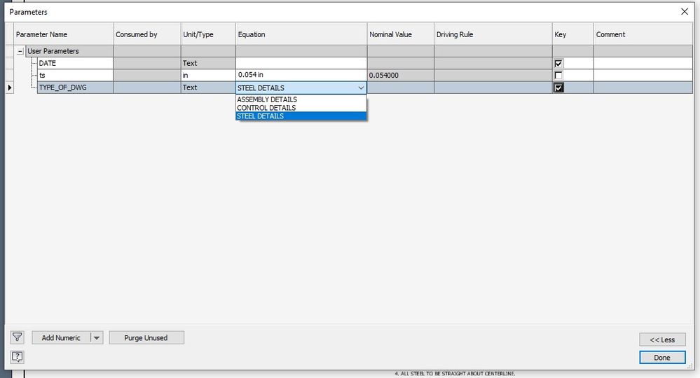

kwilson_design
I'm trying to do something similar but with an IDW file instead of a part file. Trying to navigate my way through editing the first accepted code to change things from a part file to a drawing file but not having much luck finding the right snippets to use in the ilogic editor.
What I'm trying to create is a text-based user parameter named "TYPE_OF_DWG" and the multi-value text selections being:
  • ASSEMBLY DETAILS
  • CONTROL DETAILS
  • STEEL DETAILS
I have a global form that allows the user to select the multi-value parameter. I'm task with revamping all of the ETO department drawings with a new/updated border which includes this form and multi-value parameter. Any help would be greatly appreciated!

jltw7PSW2
Hi Kenny,
Out of curiosity, did you find a solution to this?
I am trying to do a very identical thing, but I am very awful at iLogic 🙂
