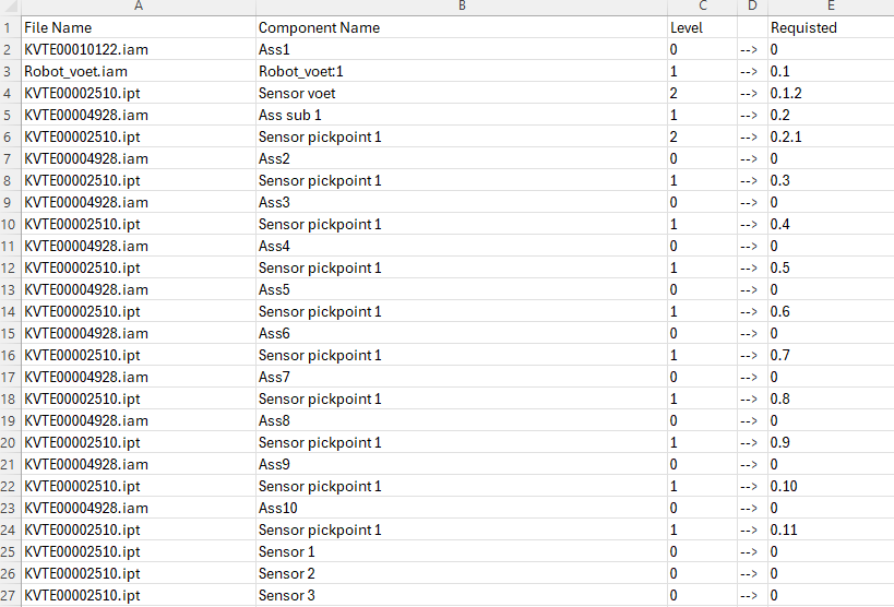

Hi!
Does someone has an iLogic rule, to run through the whole assembly and connect all filenames of assemblies to corresponding displaynames and export this to excel?
Nick

Hi Wesley,
Thanks for the reply.
I've included an image on what the output should look like. I know that the displayname can be changed.
Our idea is the following:
- AssemblyX is (for example) a conveyor, but at customerY the conveyor is conveyor1 but at CustomerZ the conveyor is conveyor10. Or maybe within one project we use the assembly multiple times and we want to rename these to Conveyor1, Conveyor2 etc, without changing the (internal) assembly-filename.
the file extension doesn't need to be included, we only want to recieve the assembly filename and the corresponding displayname, after that we can make the magic happen within excel.
Something import to notice, is that it needs to run also through all the subassemblies, and the subassemblies of these etc. All assemblies should be checked, also on deeper levels. Something nice to be added is how deep this assembly is, see also included image.
Nick

nick5MWHR
in reply to: WCrihfield
Hee Wesley
You are right. I mean the name shown in the model browser tree (ComponentOccurrence name)
as for the levels. The reason I indicate this in the way in my example is because it is also displayed this way in a BOM export if you select structured on all levels. This way we also know which sub-assemblies belong to which assembly.
If the order of the tree structure from the model browser does not change when running the rule, then the way you propose is also fine for me.
Nick

nick5MWHR
in reply to: nick5MWHR
Sorry for the late response, but we tested the code today and it works, however, we’ve got a few questions.
  1. Say we have an assembly named assembly100:1 and assembly100:2 and we changed these names to conveyor1 and conveyor2, only conveyor 1 will be in the excel file.
    1. In the previous post of you, the file names and component shows all assemblies, that is exactly what we want, only we want the level to be 1.1 etc. (which is great about your later post).
  2. Is it possible to also include all parts which have a NON empty IO name (custom iProperty)?
    1. Preferably also attached to the BOM level as above.
  3. If they do have a non empty IO property, also include in the excel the custom iProperty Fabrication Number.
    1. We want to add more properties, but if we have the code we can probably add all the remaining properties ourselves.
Thanks again!
Nick

Hi @WCrihfield ,
Again thanks for your reply!
We have modified your code to better fit our application. And now we can get most of the data we need, so that is great! Unfortunately we can’t quite get the level functionality to work as we need it. Currently we can get the level of the component in relation to the main assembly. However, we also need to get the level of the component in relation to the sub-assembly. So for example, if we have a main assembly that has a few assemblies, which also have assemblies we would need to get the level as follows: (assembly – level)
Main assembly – 0
            Sub assembly – 0.1
                        Sub-Sub Assembly – 0.1.1
            Sub assembly – 0.2
                        Sub-Sub Assembly – 0.2.1
                                    Part 1 – 0.2.1.1
                                    Part 2 – 0.2.1.2
            Sub Assembly – 0.3
            Etc.
(The . seperator is not strictly neccesary, a string of int as follows is also fine (0211). )
The code from your last post does work for this, however it only works once per unique part/assembly. In our case assemblies and parts can be used more then once.
I have attached the results from the excel sheet as they are now, and have added the requested syntax behind it. If you could help us that would be great!
Thanks in advance for your time and expertise!

You are correct in assuming that the component names would be more helpful than the numbers as we had previously suggested. I just tested both your examples and the latest of the 2 is exactly what we need. I just copied them to a string with a “ - ” as separator. A comma would also be fine.
I tried to incorporate the function in our current code, but I cannot seem get it to work for all components. Could you perhaps help us integrate this function in the code? It would be much appreciated!! I have attached the code that we currently have below. I had added more filters yesterday, but with the assembly’s I am currently using, they are not of use so I left those out.
Thanks in advance!
Message 13 of 14

Hi @WCrihfield , thank you so much for you helped, I've managed to make it work, thanks to you!
I added the following code to make add a seperate sign, which I'll later use in excel to seperate the names. I've added multiple functions to the code, but I'm getting stuck at a certain part... Maybe you could take a look at my new post?
