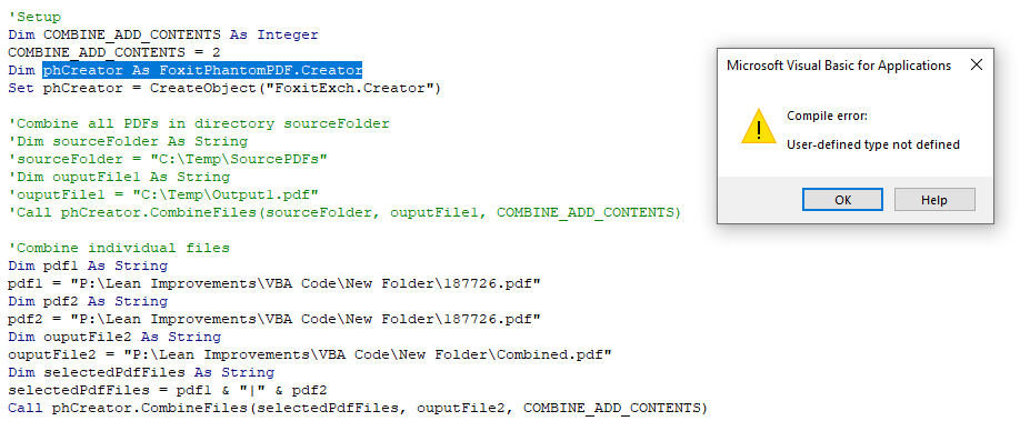

I tried running the sample test code and ran into the same problem that I experienced before (I commented out combining using a source folder and ran only the second half). The picture attached shows the error message and the highlighted code it is talking about. I think VBA might be trying to define phCreator as an object, but there is no object definition it knows called FoxitPhantomPDF.Creator. I feel like it would need to call it more, but I could be wrong.

@zachary.watsonTTAEZ this error is shown because you don't have added reference to the FoxitPhantomPDF API. But I don't know, how to setup this or if it is possible in VBA. You can try to look for it in VBA references. Otherwise try to ask Foxit support.
zachary.watsonTTAEZ
Hey Michael.Navara,
That was the problem. I was able to find a Foxit Phantom Reference and the code worked right after that. Thanks for all the help!
