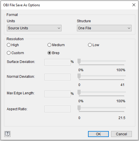

Hi @Louie_Harvey.  The second one looks like the correct way to do it.  Just use oData, not oData.String, as the last input into that SaveCopyAs method.  I don't know why I didn't think of this earlier, but the Options you are specifying will not work.  That one option looks like one you might use if exporting something to the STEP file type, but that will not apply to the TranslatorAddIn for exporting OBJ type files.  When I go to export either a part or an assembly out as an OBJ type file, when I click on the Options button, I see the following pop-up dialog.
As you can see, that option you are specifying is not present on this dialog.  So, I used one of my code utilities to extract the names and current values of that TranslatorAddIn's options.
Below is the list I got in return:
Option Name = ExportUnits
Option Value = 0
Option Name = Resolution
Option Value = 4
Option Name = SurfaceDeviation
Option Value = 16
Option Name = NormalDeviation
Option Value = 1500
Option Name = MaxEdgeLength
Option Value = 100000
Option Name = AspectRatio
Option Value = 2150
Option Name = ExportFileStructure
Option Value = 0
As you can see, not all of the values make immediate sense, so you may have to play around with it a bit to get them set the way you want them.  Usually those settings will be stored from the last time you used them, but I don't know if that is always true.  So, I would suggest that you export something to OBJ manually first, to get the settings the way you want them, then you can capture their settings after that point for use in your code.  I will attach my code utility for TranslatorAddIn Options extraction as a text file, so you can use it later.
