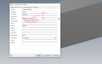

I am wondering how to create a description from parameters and regular text similar to how you are able to create descriptions in the iProperties "Description" slot.
Description example: =<TUBING, SQUARE <Width> X <Height> X <Length> LONG
how would I write this same type of "description" in iLogic using the parameters (Width, Height, Length) and the plain text of TUBING, SQUARE & Long)

Curtis_Waguespack
Hi @chris
I don't think you can insert the Parameters to be a "live" formula in this way, instead you must use iproperties.
Meaning that if you use Parameters it will simply get the value of the parameter at the moment, and will not update the description if the parameter changes in the future ( unless the rule runs).
What you can do though is export the parameter as an iProperty:
Then you can use something like this to set the formula in the description:
iProperties.Value("Project", "Description") = _
"= TUBING, SQUARE <Width> X <Height> X <Length> LONG"
This will give you a result such as this:
Recall that you can format the way the parameter export by right clicking them as shown:
And then using these options:
I hope this helps.
Curtis

chris
what I want to do with the square / Rect tubing is to have the parameter "Shape" be available in the description... but it's not working
A.Acheson
If the parameter is a text parameter this won't work directly because of the lack of export option to iproperty.
You need the ilogic rule first to create a custom iproperty and set it to the parameter value.
iProperties.Value("Custom", "Shape") = Shape
What is being used in the forumula is not the parameter but rather the iproperty name either.
