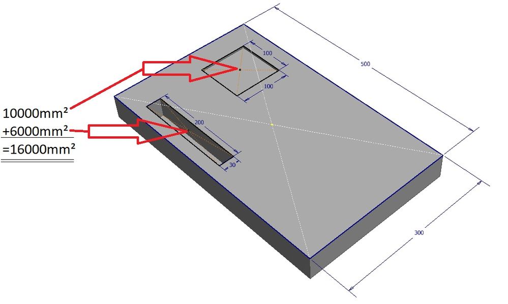

Hello all, this is my first post so hopefully I have posted this in the right place. I have searched the forum but to no avail.
Is there any way of calculating the accumulated size (not all surface areas, just the Width x Height) of all extrusions within a part via iLogic/VBA?
Example1:ExtrusionSize.jpgThis simple part contains two extrusions, adding up to a total of 16000mm². But there can be many more extrusions within a part on some occasions, or no extrusions at all on other occasions. (Or also just the square part itself. Which then of course would result in a value of 0mm²)
Example2(with a few more extrusions):ExtrusionSize2.JPG
My company are producing foam inserts on a CNC router, and I am hoping to use these numbers to estimate the milling time of multiple parts within an assembly.
All parts are rectangular before milling, but contain different shapes and sizes of extrusions within.
Manually it is of course no problem to find these values with a calculator and a pen, but we are hoping to having it done automatically and export the value from the BOM and into our ERP-system.
Could this be done with iLogic or VBA?

torbjorn_heglum1
When you have created the machined part, create a new body equal to the block before machining.
Then you can subtract the machined body, and the remaining will be the machined (removed) volume.
Torbjørn

Hi and thank you for your reply.
These foam inserts are drawn in the final thickness, and then split up into sheets of 50mmExtrusionSize3.JPG before milling.
So I'm hoping for a solution whereas we do not need to go into each sheet and performe a manual prosedure to get the values needed for the time calculation.
Regards

JDMather
Your equation example is calculation of an area (mm^2), but your problem description sounds like you need calculation of a volume (mm^3) removed.  I guess it doesn't matter if you machine time is not depth-of-cut dependent.
I would use a Derived Component.

mcgyvr
A quick manual method is to simply create a new sketch on that face and then use "region properties" to select the face and get the total area..
Then subtract that from the total area of the stock..
Message 7 of 8
johnsonshiue
Hi! There should be an API/iLogic rule solution. If you want to do it manually, you can use Region Properties. Create a sketch on the face with the cutouts. Project the face/edges. Go to Tools -> Measure -> Region Properties -> select a profile. You will see a lot of properties for the selected profiles.
Many thanks!

rayessle
In the part attached (inventor 2018) there are two ilogic rules. The first one (area) will place the area of all regions in a sketch called "area" into a custom iproperty. The sketch was made by projecting the edges of the extruded cuts. The second rule called "pick" lets you pick a face then puts the area into another iproperty. You should be able to use the first rule as a starting point to get what you need. You could then trigger this rule to run on a parameter change or save to update the values automatically as required.
