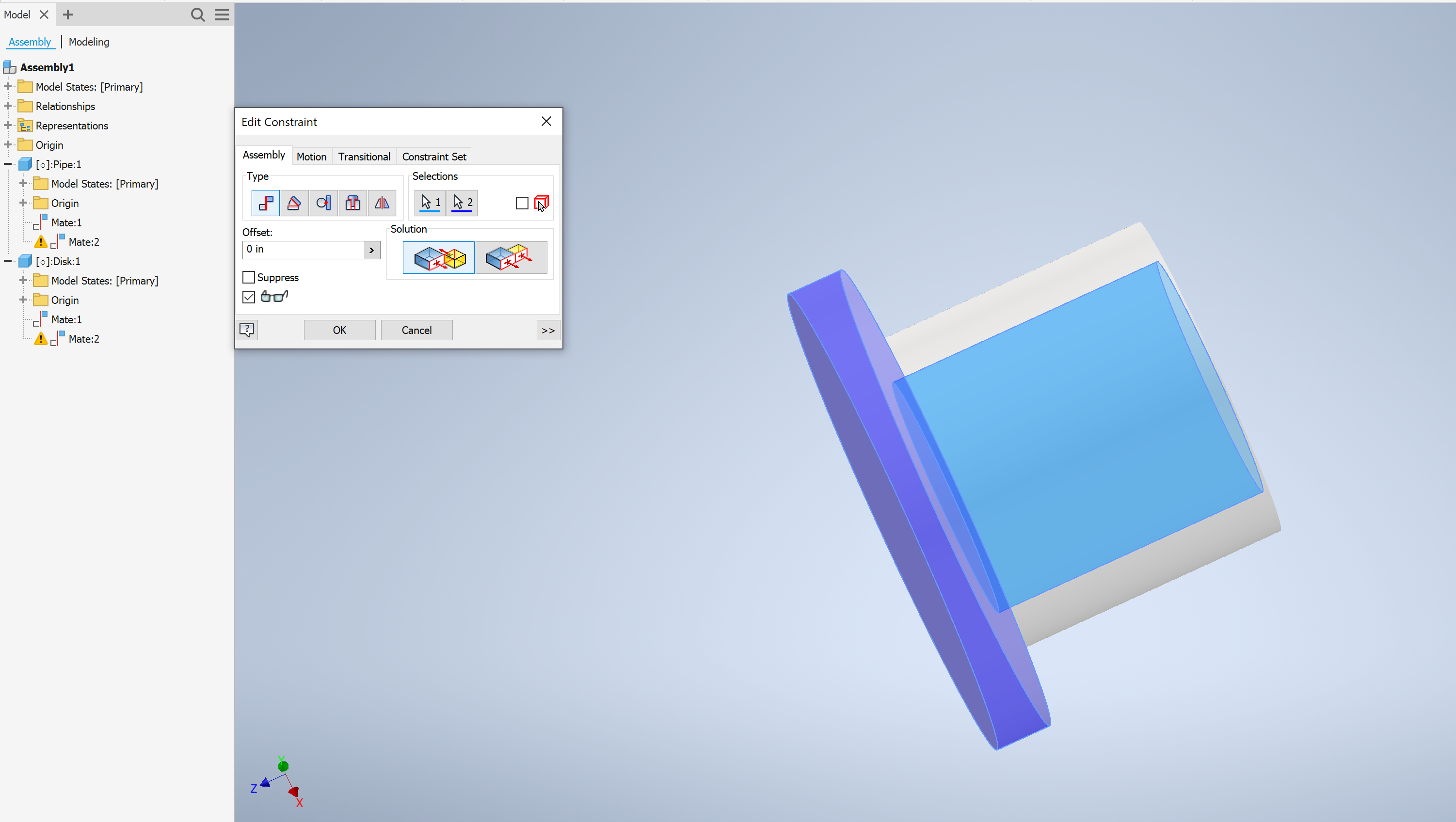

I am fairly new to using the Inventor API and trying to work out how to do just basic functions using C#. I am having a lot of difficulty finding good resources for C# as everything seems to be written in VBA for examples. All my code is trying to do is access an open assembly document, import two .ipt files, and add mate constraints between the two parts. The first part is just a  thin-walled,  hollow cylinder and the second part is a thin disk. I search the faces for each part and find the planar faces which should be the flat part of the disk and the rim of the cylinder, and try to add a simple constraint between them. Then I search for cylindrical faces and try to add a concentric mate constraint as well.
The issue I am having is I do not know how to properly make the concentric mate constraint. Running the program adds both constraints as planar mates and it gives a Inconsistency warning on the second one. I need help manually creating a concentric mate for the cylindrical faces in my code.
Here is my code:

Any help would be appreciated!!
